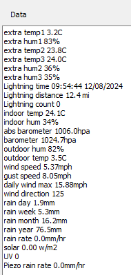

The cron left side is the raw data in json format. AFAIK only the right-side data from the cron job have been parsed by WD. . . so extratemp/hum1-3 will end up in clientraw.txt, for instance. I have no idea how LDS01 data is used by WD: is it shown on the main screen? I just checked a tagslist from 18 February download and I can’t see any snow/laser tags, either. . . Data certainly won’t be in clientraw*.txt as they are set in stone.
Here’s my cron data:
(BTW I don’t have piezo rain. . . )
