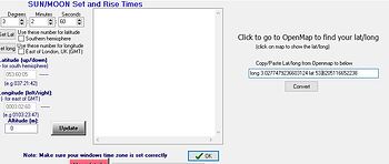

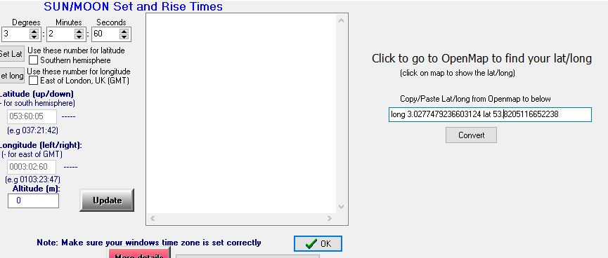

I just tried setting my lat/long using OpenMap and it gave me some odd values. It set my latitude to 53:60:05 and longitude to 03:02:60. I expected minutes and seconds to be in the range of 0-59 so I wouldn’t have thought that 60 was a valid value? See attached image for the raw data.
Having just checked another way the converted numbers are further wrong than I thought…
My Lat - 53:49:14
My Long - 03:01:40

The data provided by OpenMap is correct. It looks like the conversion from decimal degrees to degrees/minutes/seconds isn’t working properly. I’m not sure but it looks like it’s taking the decimal degrees value and using the first two decimal digits as the minutes. If the number of minutes is > 60 then set it to 60. This seems to work for my and Budgie’s latitudes, i.e.
Mine - 53.8205 turns into 53:60
Budgie - 56.7152 turns into 56:60
