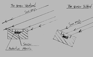

Yes stars, it was me who posted that on 10th December 2008. Like you I had been unhappy with the UV data from my sensor. So, I decided
to experiment and found, if I tilted the sensor so that the eye on the top faced directly at the sun at mid-day in mid April, it would give acceptable readings for the rest of the summer.

I don’t agree at all. These sensors are built to measure horizontal irradiance, they have to be mounted flat horizontal. If you tilt the sensor you’re biasing the readings. That’s why you get higher readings than your official met service.
I live in northwest Spain, even in a sunny winter day it’s not easy to reach 1 or 1.5 UV index, so imagine in Sweden…
I don’t think that you can make that assumption for an inexpensive UV sensor such as this. My assumption has always been that the optical design is not correct and the above description of the UVN800 construction supports that. If you look at the Davis it has a lens/diffuser that (to make another assumption) does correct the spatial response.

And if the sensor is constructed in the way you say how does the UV radiation get to us…only on our heads or the wohle body…

I think all piranometers and radiometers are constructed that way, no one has the sensor itself (photodiode) completely exposed. They are “buried” inside the body with a lens or diffuser on top. Is that diffuser which makes the adecuate cosine response. Look at some hi-tech schematics:
http://www.yesinc.com/products/data/uvb1/index.html
http://www.hukseflux.com/products/solarRadiation/nr01.html
So I think the plastic cover stars talks about is really a diffuser (not just a protective cover). Regarding Davis diffuser look at the specs sheet: [i]"Diffuser
Maybe you’re right, I still can’t undestand how Oregon call this thing a “radiation shield”…
Anyway I think tilting the sensor is not the best choice to make it work.
