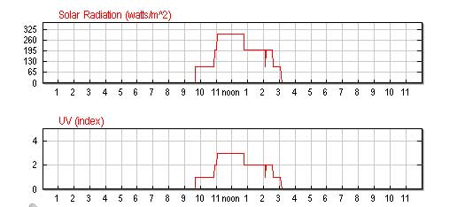

I don’t think you will get very good sunshine hours using a UV sensor. As you can see from the graph the Solar Radiation is an estimate generated by multiplying the UV index by a fixed number. That is a very approximate number.
The sunshine hours calculation compares the measured (or in this case estimated) watts/m2 value to a theoretical maximum solar calculated for your latitude, longitude, and time of day as it would be measured by a “real” global solar radiation sensor. You set a threshold percentage above which it is “sunny”, eg if the measured value is 75% of the theoretical maximum, and WD counts the time the percentage is above that value and reports it as sunshine hours.
