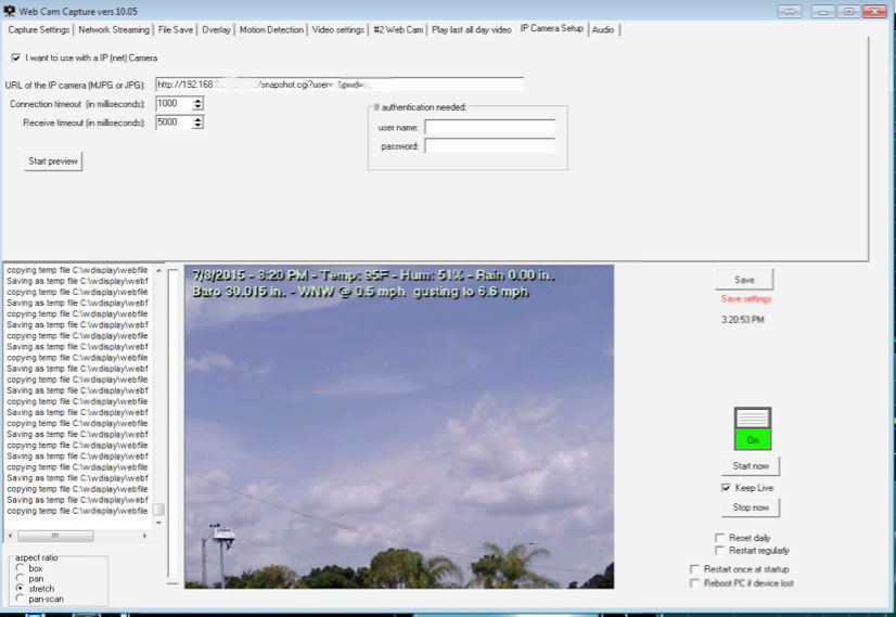

What I did for my setup is create a user on the camera with view only permissions. I then enter the following in the URL box (see attachment).
http://192.168.x.xxx:xxxx/snapshot.cgi?user=username&pwd=password
Sub your IP, port, username and password for the xxxx’s. The stream shows up in the box as a video.

I have the video withing Webcam Capture. My question is how do I view the video from the web via a URL? I have tried all the syntax urls on the page and none of them access the camera to see the video. I can see a live video feed from my cell using an app which logs in automatically with my user name and password. No problem there. But I cant seem to get the URL syntax correct to view it from a web browser. What I want to do is recreate a live video link for my web page. Any syntax I use brings me to the Foscam log in page.
