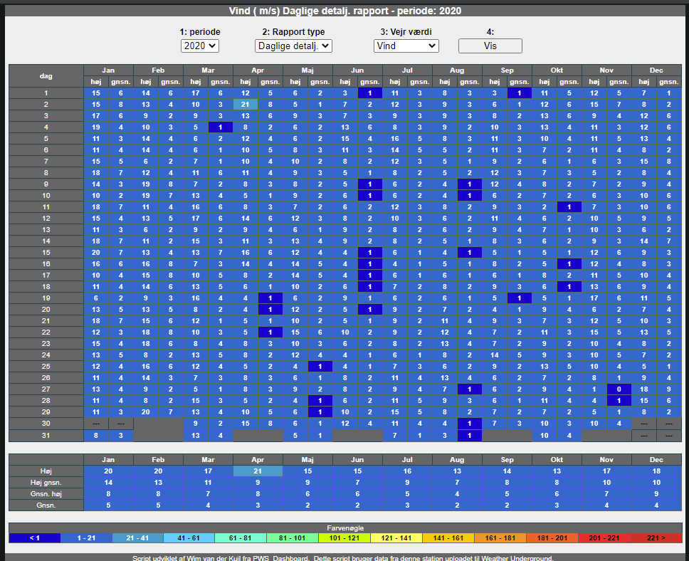

I use m/s as a unit for wind strength.
In “Reports at WU” almost all wind speeds are shown with the same color, because the numbers in m/s all become quite small.
See attached screenshot.
Would it be possible to make another differentiation for colors when m/s is selected?

Please make a copy of wureports/wsReports1part.php first.
change line 350 and line 372 from
	$windInc	= 20;
to
	$windInc	= 2;
If that makes to much red colours set it at 4;
Have pleasant and quit NewYears eve, best wishes for 2021.
Thank you very much - it made the difference :D.
Now the colors are very illustrative.
