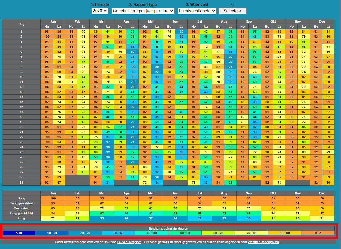

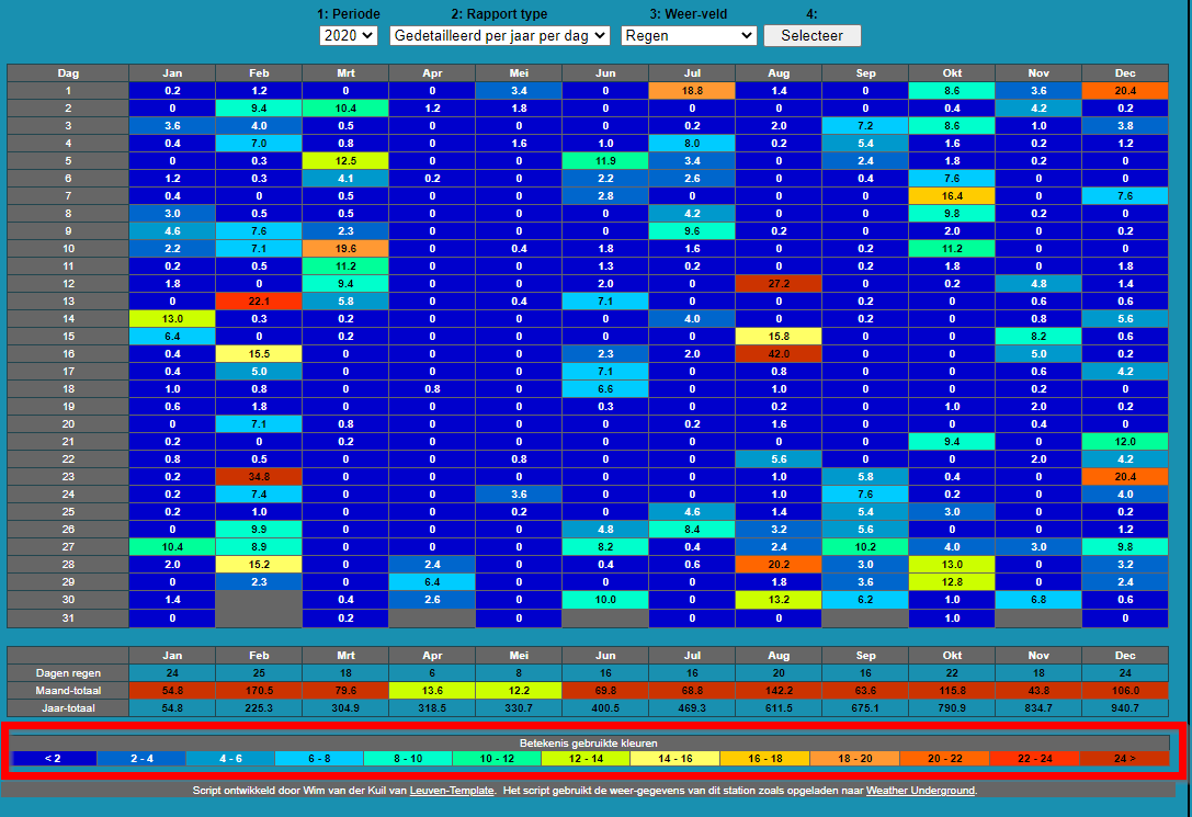

Cosmetic question about the standalone version of WSReports.
Is it maybe possible to invert the color range for the rain and humidity levels, this seems a bit more logical to me.
So with a lot of rain a dark blue block, with no rain a red/orange block.
The same applies to humidity, so with a high percentage a dark blue block, with less a red/orange block.

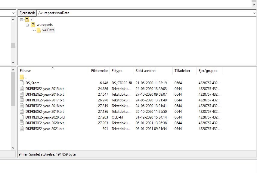

My “Reports at WU” also lacks data for December 31, 2020.
I saw that this data is found in “History at WU” and I got the idea to read the numbers there and write them into “_wu_upd.php”.
But in “_wu_upd.php” the data for December 31, 2020. are also found. They just do not appear in “Reports at WU”.
Mogens
Yes, most of the recent scripts use the new format as stored in the .arr files created by the MITM script.
The “very” old scripts still store their own cache as they are not aware of the MITM scripts.
Just rename the current https://inaogmogens.dk/wureports/wuData/IDKFREDE2-year-2020.txt file.
The 2020 file will be recreated from the correct .arr

I renamed the file and a new one is created.
But the new file also lacks data for Dec. 31. 2020
Probably the .arr is incomplete then also.
Then it will be for later, in March as said before.
Need to have enough time + a stable release to dig in those different scripts.
Thanks for being aware of that :smiley:

Delete / rename both
https://inaogmogens.dk/weather/wudata/2020/IDKFREDE2-year-2020.txt
The .arr file is correct https://inaogmogens.dk/weather/PWS_listfile.php?file=wudata/IDKFREDE2-metric-2020.arr&type=arr
So the .txt should be recreated.
Super :smiley:
it managed!
Thank you very much

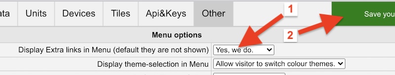

You do not have to manually add the URL's You have top change _my_settings/frames.php. Line 28-30 read now
# this one is optionally  used if you installed wu history and reports
$show   = true;
$show   = false; // add the # on position 1 if you want these wu scripts
Line 30 should be set to comment by adding a # on the first position.
# $show   = false; // add the # on position 1 if you want these wu scripts
Then the pwsWD/index.php?frame=History_at_WU link from the menu will work for the history
and the pwsWD/index.php?frame=Reports_at_WU link will work for the coloured table.
Do not forget to first change in the settings
=> Tab other
==> Display Extra links in Menu
See attached screenshot.

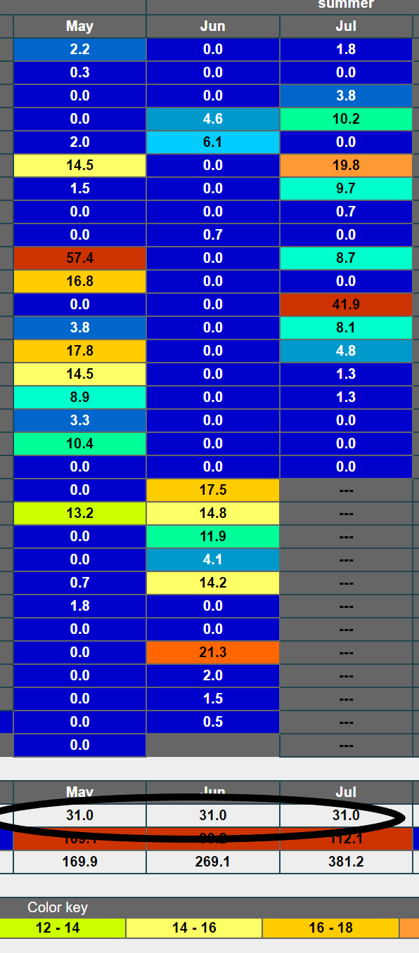

The number of rainy days remains at 31 only the colors show the number of rainy days I cannot find the problem in the file: wsReportsSum.php
I appeal to your help because my programming knowledge is very limited
Thanks in advance
Cordially
http://fleurie-meteolive.fr/ECOWITT/index.php?frame=Reports_at_WU
Related question: would it be possible to show the number of raindays as integers?
There seems to be a mixup with old and new and or stand-alone versions.
Your https://fleurie-meteolive.fr/ECOWITT/wureports/startReports.php?sce=view shows at line 13-15
$SITE['wuStart']        = '30-04-2021';	  // Important the format is:   dd-mm-YYYY  for your first day of uploading data to WU.      !
$SITE['wuID']	        = 'IFLEUR35'; 	  // your WU station name
$WUdatastr              = 'http://fleurie-meteolive.fr/ECOWITT/PWS_DailyHistory.php';
while other users show the correct lines
$wustart 	= '01-08-2017';	  // Important the format is:   dd-mm-YYYY  for your first day of uploading data to WU.      !
$wuid		= 'IEDINBUR98';	// your WU station name
$WUdatastr      = 'https://swanston.maui.co.uk/pws/WXDailyHistory.php';
That is why you have errors in the first place:
Warning: Undefined variable $wustart in /htdocs/ECOWITT/wureports/startReports.php on line 15
Warning: Undefined variable $wuid in /htdocs/ECOWITT/wureports/startReports.php on line 98
I have no idea, need to look into that if things calm down here.
$wustart 	= '01-08-2021';	  // Important the format is:   dd-mm-YYYY  for your first day of uploading data to WU.      !
$wuid		= 'IFLEUR35';	// your WU station name
Good evening WIM,
I corrected the three lines and there is no more error message
On the other hand, the number of rainy days remains at 31
Could you send me back the last script cause I must have mixed versions
Thank you again for your help which solves many concerns
Cordially
