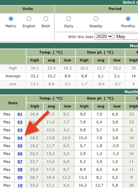

The text is changed to “'No valid data for the period found” and a link to restart the script.
When you take the month or year view, you can click on the “blue” day number link and it will go directly to that day without using the menu.

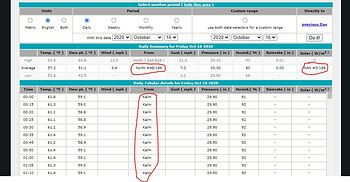

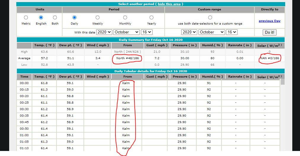

I’ve got a couple of questions concerning the History at WU script output.
– I’ve noticed that the word Calm (English) is spelled Kalm in the script. How do I go about making a change to display the correct language?
– The average wind always displays Direction (North) then #XX/XXX. I’m not sure what the # is for and what this data is stating.
– I don’t use solar with my station and the solar column states “NAN #0/186”. Is there anyway to stop this output? Could it display a “-” or delete the column all together?
See the attached image for examples
As always, your time is much appreciated
Michael
relayweather.net
There is a language translation file, ./wuhistory/wulanguage-??.txt
The English one has a translation error for the word Calm on line 70
langlookup|Calm|Kalm|
change to
langlookup|Calm|Calm|
-- The average wind always displays Direction (North) then #XX/XXX. I'm not sure what the # is for and what this data is stating.
It displays North as the zero value is used for both “no winddirection” as “North” in the .CSV
As this is a script to analyse your history, it gives a count for the prevailing (average and high) winddirection
#XX/XXX such as #12/68 means 12 times this direction was reported of the 68 reported measurements
The settings are in the main script WU-History4.php lines 40 - 56
Solar is at line 48, set it to false
$showSolar      = false; // if available
Succes, Wim

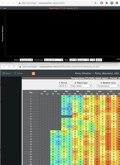

I’ve noticed another problem. This is happening with both the WU Reports and WU History. It seems that WU History and WU Reports is not returning the data in certain cases. I checked WU directly and it seems that all of my data is available back to my WU data birth year (FEB-2008)
Example in WU History:
If I choose to look at daily data for a date in January 2019, it returns data that appears to be correct.
If I choose to look at monthly data for January 2019, it returns an error “Scripts failed, check html for problems”.
If I choose to look at yearly data for 2019, it returns data that doesn’t return January at all.
Example in WU Reports:
If I choose to look at daily detail for a date in January 2019, it returns data that is missing January 1 through Feb 14.
If I choose to look at monthly summary for January 2019, this script appears to hang

Hi Wim,
I deleted and had the script download both files again, and the same result. After checking these two files, it appears as if the data exists within both of them, but the script seems to skip this data.
It’s really not that important to dig into, I just wanted to let you know the status of my issue.
Michael
KMDRELAY1-month-201901.txt (2.45 KB)
KMDRELAY1-english-2019.arr.txt (32.2 KB)
OK it seems this is a slightly older version of script.
It also caches the old yearly data, which is not necessary as there is a master cache in the .arr files.
Remove pwsWD/wureports/wuData/KMDRELAY1-year-2019.txt and the file will be recreated as the .arr is correct and the history script displays the data from Jan 1 2019 and onwards.

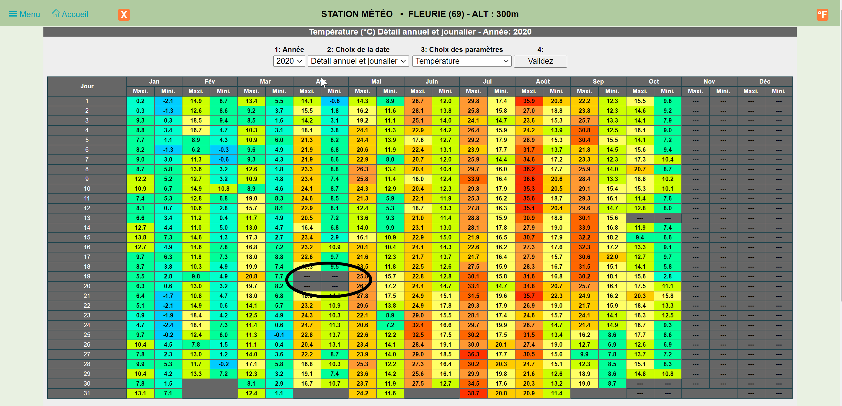

On the other hand, in the data complete days are missing and I cannot insert a missing date with your program with the file: WU-History4.php
is there a solution to add a missing date?
(Image attached)
http://fleurie-meteolive.ovh/index.php?frame=Reports_at_WU
Thank you in advance for your help
Kind regards
Language history-fr.zip (1.6 KB)
language reports-fr.zip (1.48 KB)
@ALL: Please post all language files in the special topic for language files.
My native language is Dutch (Netherlands). So there is not much I can do with dozens of language files I do not understand and therefor can not check.
. . . in the data complete days are missing and I cannot insert a missing date with your program with the file: WU-History4.php is there a solution to add a missing date?
I wrote a script to update those data arrays as they are used by all WU scripts used in the dashboard
All information is found here=> WU data arrays Update Script ** Closed **
Give it a try. If you run into problems post your remarks in that topic “WU data arrays Update Script”.
Succes, Wim
