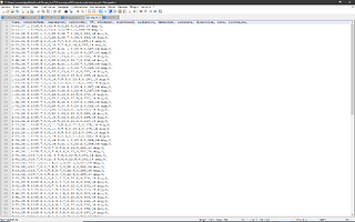

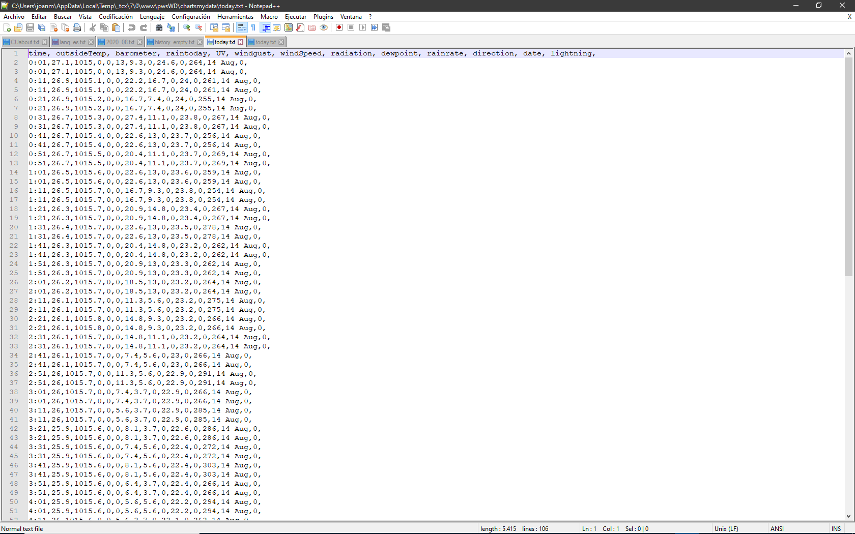

Good morning, it is the first time that I am writing to you, for a short time I have activated the “pwsWD” template after configuring, it works apparently well, however in the “chartsmydata” directory I observe that the recording is done in duplicate and not I know how I can fix it, I’m using Weather Display and Weather Display API, otherwise the template seems to work fine.
I attach an image of this file,
Thank you very much

11:58,27.9,1015.7,0,0,18.5,7.4,0,22.4,0,343,14 Aug,0,
12:08,27.9,1015.7,0,0,19.3,9.3,0,22.4,0,341,14 Aug,0,,1597399896 2020-08-14T12:11:36+02:00 www.meteobadalonaprogres.com/pwsWD/w34_cron_stationcron.php
12:08,27.9,1015.7,0,0,19.3,9.3,0,22.4,0,341,14 Aug,0,,1597399958 2020-08-14T12:12:38+02:00 www.meteobadalonaprogres.com/pwsWD/_test.php?test=PWS_cron_stationcron.php
12:13,27.9,1015.6,0,0,22.6,13,0,22.4,0,335,14 Aug,0,,1597400014 2020-08-14T12:13:34+02:00 www.meteobadalonaprogres.com/pwsWD/w34_cron_stationcron.php
Two lines with data from 11:58 = old station cron started by WD
Two lines with data from 12:08 = station cron with the test code started by WD both executed in the same second at 1597399896 = 12:11:36
One line with data from 12:08 = station cron started by me in the browser at 1597399958 = 12:12:38
One line with data from 12:13 = station cron started by me in the browser (different URL) at 1597399958 = 12:13:34
