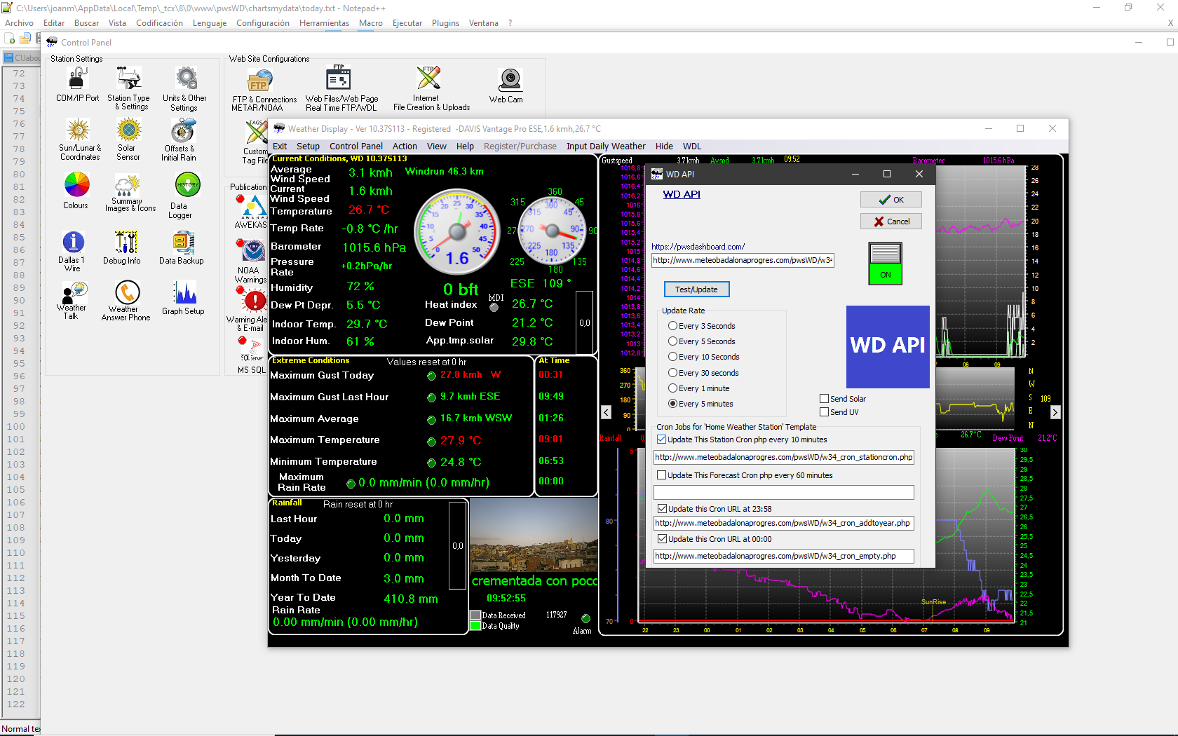

Yes, WD is executing every 5 minutes a cron to the Meteotemplate database
But that is the same WD-program.
The program is running only once in your home network and it is doing both the cron to Meteotemplate and to the Dashboard.
Correct?
yes

You can run multiple crons in WD.
You can also run multiple WD programs. And when they access the same settings-file this could also happen.
But you said you are only running 1 Wd-program inside your home.
So there must be another cause to have two crons starting in the same second every 10 minutes.

Perhaps a fresh install with the pwsWD template, newer starting from 0 might fix the problem.
Sorry, there are two cron accesses from your local network.
Therefor, this is not a problem in the PWS_Dashboard yet.
This seems to be a problem of either a duplicate WD started on your PC or two PC’s running 1 WD inside your local network.
When I look at the screenshot just below the webcam, the 09:52:55 screenshot has 117927 data-packets received.
The one from six hours later at 15:05:24 has less packets at 6543.
You are sure that WD is only started once?
Did you already restarted the PC just to be sure?

It seems WD is switched off for your websites.
If you are restarting, I attach the PWS_cron_stationcron.php script which checks for to frequent cron executions.
There must be at least 60 seconds passed before the script will add lines to the graph-files.
PWS_cron_stationcron.php.zip (3.46 KB)

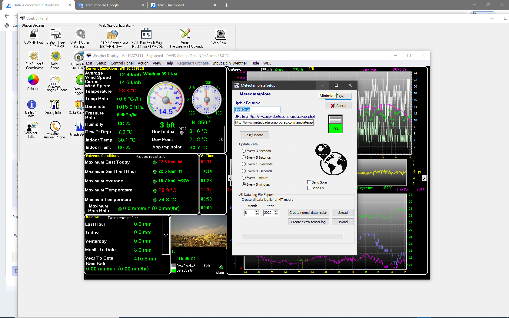

what is the update interval set as?
Attached a screenshot the OP posted
5 minute update WDapi
10 minute cron
The cron is executed twice in the same second coming from the home network external IP address.
Starting the cron using my browser it runs only once
