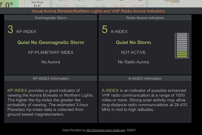

Auorora (KP-index) file missing ** Updated **
The pop-up for “Visual Aurora Borealis/Northern Lights and VHF Radio Aurora Indicators” used in the sun-block is missing the essential file to do all the calculations.
There seems to be no replacement for that file yet.

Those who are using the status pop-up will get a red exclamation mark for an outdated file.
@ALL => block the download of the file
=> PWS_load_files.php around line 257, set the line with fnctn_load_file (‘Aurora-kindex’); to comment with a #

@ALL Attached updated versions of the two scripts which use aurora data.
And the PWS_load_files.php with the new URL to load the new file.
Have fun with testing,
aurora.zip (16.7 KB)

The kindex.txt file can be downloaded from noaa.gov (by selecting the aurora popup) any time, allowed age is only 5 minutes. . . even though Kp is only updated every 3 hours! I don’t know exactly when the NOAA page is updated.
@ALL
If I understand this discussion correctly:
[ol]
[li]File to use should be https://services.swpc.noaa.gov/products/noaa-planetary-k-index.json[/li]
[li]K-index should be the last value[/li]
[li]A-index should be the the average of the last 8 values[/li]
[li]File reload should be reset to 1 hour [/li][/ol]
If correct, I can change the script that way.
But it will show “very” different values compared to the current version.
Currently the A-index is calculated from the Kp-index.
I will add a link to the WiKipedia article at the bottom.
