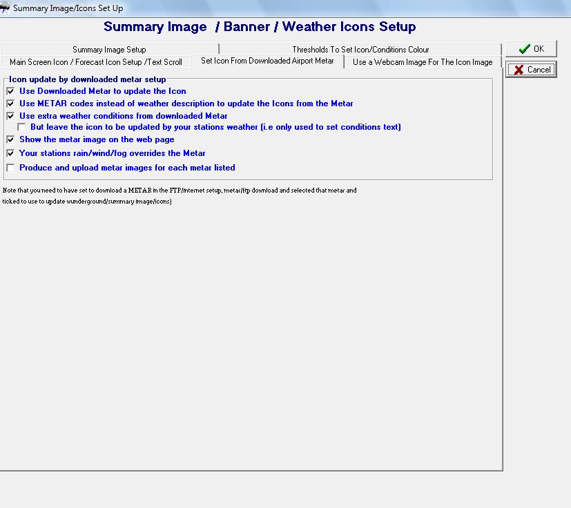

Here’s screen shots of settings

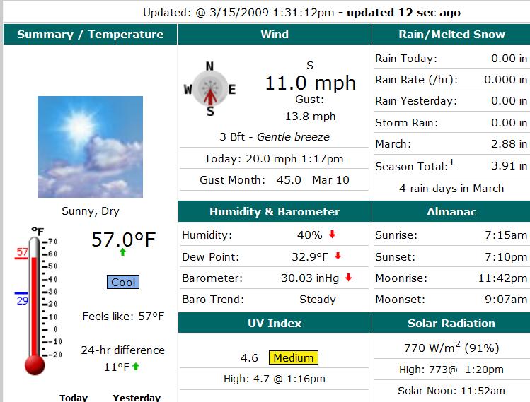

Right now Solar Radiation Is 91 shouldn’t I have just a Sun Icon?

Brad,
On your summary image uncheck the use downloaded metar to set icon. Uncheck the first two boxes. Try that.
Chuck
That didn’t make any difference. rebooted WD also just to make sure

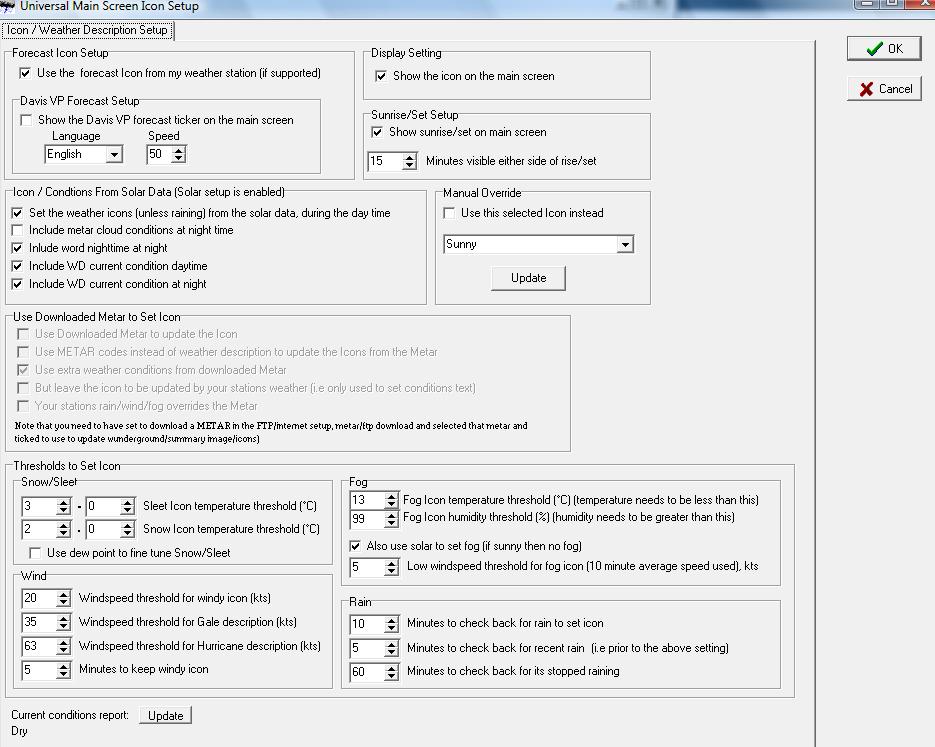

Attached are 2 more Images Of settings.
If a person Reads what I have have circled in first It looks like P/C Icon Is the default and That’s what I am getting during the Daytime Hours
To Me somehow I have Icon stuck On Default

Settings Image
Try unticking the first box on the Icon1 new and see what that does.

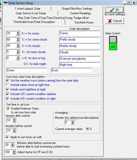

How about trying this idea?
Generally if you have a solar sensor, you’d want it to estimate the sky cover during the daylight hours, and use a nearby METAR for that info by night.
Here is what I’d used:
Ken

Ken Your settings did the trick. Thanks again for the images.

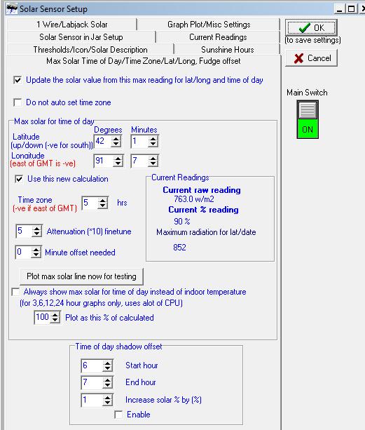

For some reason my solar is at 100%. My settings are like Ken’s I am wondering if I am missing something else.
Chuck
I think it has something to do with the Max Solor Time of Day/Time Zone/Lat/Long. Fudge offset. I may have to adjust the some settings. Not sure though.
