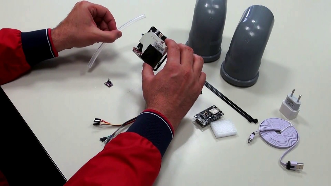

I made one of these ages ago and its still running and reporting fine. The only thing i did is I didnt put it in those pipes. Mine is mounted inside a box on the wall of the garage outside and has a whole which the small tube sucks the air in and then reports the reading to the sensor, all working fine.
