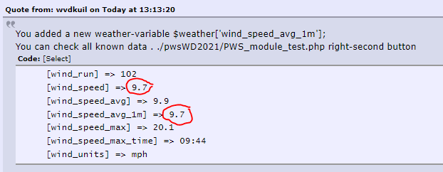

You added a new weather-variable $weather[‘wind_speed_avg_1m’];
You can check all known data . ./pwsWD2021/PWS_module_test.php right-second button
    [wind_run] => 102
    [wind_speed] => 9.7
    [wind_speed_avg] => 9.9
    [wind_speed_avg_1m] => 9.7
    [wind_speed_max] => 20.1
    [wind_speed_max_time] => 09:44
    [wind_units] => mph

Just noticed that you seem to be using $wd[1] for both one-minute average and current windspeeds. The second line should use $wd[2] for current windspeed - what used to be called “wind_gust_speed”. I thought that was the whole point of your change?

You must have changed it before, I think it started life as $wd[2] :slight_smile:
