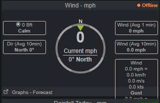

I’ve been watching this and it’s not just because there’s no wind: see zero.png below from 2 March. It’s also been happening today and I don’t think you’ve had zero wind today?
There might be a clue in zerozero.png below, about 15 mins after zero.png: the block is “Offline”. When I was watching today the block went offline, the anomaly appeared, and then disappeared when the block came back online. BUT immediately after that the rain block went offline, and then the temp block went offline.
I would guess that WD has trouble creating and uploading a valid clientraw.txt as often as you want?

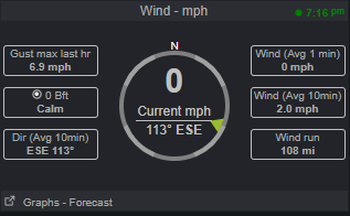

Anyway, try the wind block in Bashy.zip (make a copy of yours first!). I’ve stripped out all the conditionals, so you shouldn’t get the anomaly any more, and you can move the little boxes around as much as you like. (I tested it in my old version of the dashboard.) You still need to change PWS_livedata.php around line 1578 if you really want to show 10-min average direction, though.
And I put “Current Wind” in the middle, to help make it clear that the direction is current as well as the speed. The wind units are in the block header, and they change if a visitor changes units: “Current mph” would be confusing.

Found few spare mins and implemented both, so far so good, thank you :slight_smile:

P.S. the 10-min average for direction looks much better :slight_smile:
