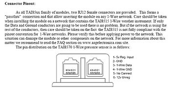

Hmmmm…the pinout for the 8570 shows pin 1 to be +5v and pin 2 to be ground. Perhaps I can add power directly to the baro with a old 5v cell phone charger I have. :lol:
the +5v is the data line from the PC
but that is what a hub does, it power the micro lan, instead of the pc doing that
but if you can power components in the aag baro and keep that power circuit separate from the pc
but then there is the problem of opamps, and the supply voltage dropping/changing, that then causes changes in accuracy of the baro
i would contact the manufactured before you go and put 5 volts into the unit

According to Gerardo Perez at AAG, I can add a 5v power supply to pins 1 & 2 on the baro. I don’t know if I’m going to do that, or do their external power mod to the DS9097U. I suppose I will wait till the outdoor humidity sensor from ibutton gets here, and see if it has any effect on the rest of the sensors data.
