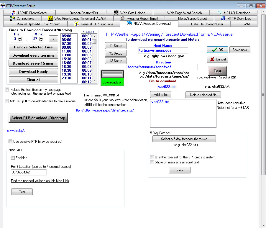

Shots at some config pages attached:
Okay, I found the error in the NWS URL for zone forecast. URL had changed.
It fetches zone forecast fine, but text does not insert into wx2.html outputted page. Should I use %metar/report% or %metar/report=%VAZ022.txt

First, sorry I put this in bug forum. I’ll try to keep “help” things in appropriate forum.
Anyway, SOLVED. I’ve been having the local text zone forecast downloaded into the main WD directory for years. Having it now put into the (local) METAR folder made it work (display correctly on processed page). Don’t know why something changed. Just one day it stopped appearing on page. Maybe it was because I was duplicating forecast download with HTTP download AND Forecast download, though that had been going on for a long time and it worked. Still scratching head, but all’s well that ends well.
I did find the huge tag list in the PDF manual. The %metar/report=%vaz022.txt tag was right. … if directories chosen, etc. are right.
