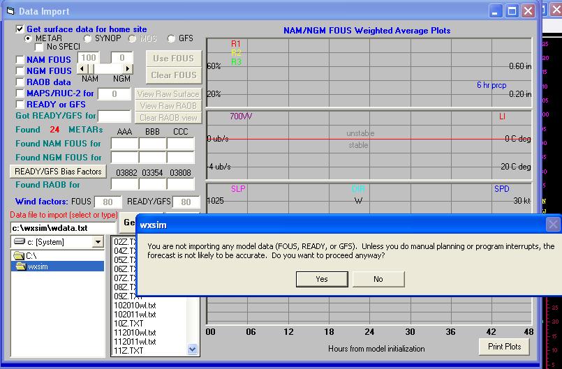

you are not importing any model data...
…FOUS, READY or GFS, Unless you do manual planning or programme interupts, the forecast is likely to not be accurate.
do you wish to proceed?
My wxsim keeps getting stuck on this screen, suddenly from months of working perfectly.
I have tried running at varous times of the hour and have ticked DST box.
any ideas?
i have followed advice in this thread.
i am using version 12.6.3
when i click import, import data, i just get the same box with the error message.
i can see that the METAR circle in the top left is checked, and everything else is unchecked.
i cannot access the screen as the error box doesn’t allow me.
it says do i wish to proceed?
either way, yes or no, it doesn’t allow me to change anything.

I have closed and reopened but am definitely not running a forecast when I get the message.
when the auto forecast runs I do get it so I click ok and it runs without data.
however afterwards to solve it I click import as the thread said and the message appears.

I click on import, then import data
I then get the error message with the tuck box screen in the background that I can’t access.
Can you send or post a screen shot of this? I’ve just looked at my code and the only event that should be able to trigger the appearance of that message is if you click the ‘Get Data’ button. All I’m wondering right now is if you can save settings. Make sure auto run is off, and JUST check the boxes. Somehow, the Get Data button is getting ‘clicked’, either manually or by doing this while it’s in auto run. I think I forgot to make a point that you need to turn off auto run first (under Start/Auto Run).

here you go - attached screen shot.
i have disabled the auto run and am not running a forecast.
in wxsim i click
IMPORT
then
IMPORT DATA
then i get this screen
there is nothing that i can do to tick the boxes or access the screen behind.
every auto forecast run just halts at the grey box, posted above.
i have to click something (yes/no) to get rid of it, then the forecast runs in about 5 secs and doesn’t have any imported data.
This is strange. It’s exactly what I get if auto run is NOT disabled. Somehow, it’s still enabled. Otherwise it would not even be trying to make a forecast. I believe you that you tried to disable it, but somehow, it’s still “on”. Maybe it’s that you have ‘start scheduler on next boot up’ checked on the auto run form, and then you open the program and it goes into auto mode. Try making sure that box on the auto run form is NOT checked.
