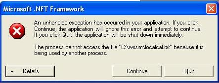

wxsim stalls
every now and then and i get this message…attached
any ideas?
thanks

I had something like this problem. What I did was set wxsim to start a bit later after wxsimate, about 15 minutes, I figured that wxsimate was still writing to the file when wxsim started up and wanted access to it. It worked for me.
Edit: Seems it was a “permission denied”-error, but it might help with this as well.

Been trying to extend the time between wxsimate and wxsim to get rid of the permission error.
I am also sorry but I did not look at the message thoroughly. The error message I got said it could not write a boolean data. At the moment I’m able to use wxsimate on the new machine but the Import of local data takes ages or at least minimum 10 minutes. Importing and processing the same data on the old machine takes less than 3 minutes. Very strange…
