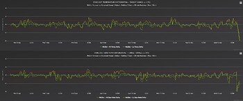

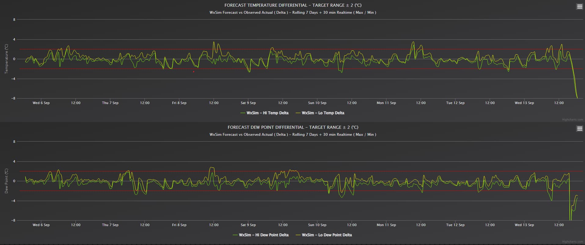

I have always been proud of my Forecast vs Actual, though right now something is way off.
Temp Wise anyway, I like to aim for 2 Degree C (+/-). though right now Dif is up to near 8 DegreeC.?
https://beaumaris-weather.com/wxsimcsvmysql/realtime_graphs_wxsim_Act_WX_Delta.php
https://beaumaris-weather.com/wxsimcsvmysql/realtime_graphs_wxsim_Act_WX_GFS_Runs.php
https://beaumaris-weather.com/charts_Combined_Forecast_Actual.php
Note: We do have Fuel Rreduction Burns occurring in the Extended Areas, though I would have thought due to their location would not impact Temps that much.
I was just addressing (solving?) another user’s problem, and it turned out in that case that WXSIM had ingested some obviously out of date RAOB data (seemingly from another season!). As the RAOB data is identified only by the day of the month and time of day, I think WXSIM may have unknowingly “eaten” data from an entirely different month (I’m not sure why that would be there). As a quick precautionary, temporary, possible “fix”, please try UNchecking RAOB data under Import/Import Data. Also, that’s a good time to check and make sure the file you;re imoprting there is wdatamixed.txt, and not the (unmixed) wdata.txt.
Let me know if that helps!
Hi Tom,
Thanks for the info.
With ref to the RAOB issue, not sure if that was the cause in my case or not, but leaving it checked for now as accurracy seems to be getting better again. I feel it may have been Seasonal Change and an out of the norm high heat spell that hit us and currently the mainland. Will bear it in mind though for future.
