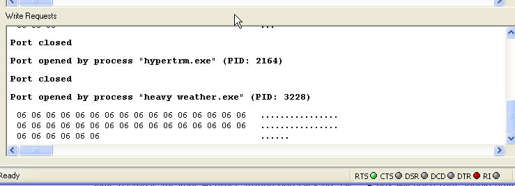

Experienced the same problem lots of times. I have installed a “Serial Port Monitor” to check if there is even traffice from the station to the PC. Often it is the connectivity from the plug into the station - and mostly I can fix it my moving the cord/plug “around”. Lately, I

The trick is that the WS230X draw power from the com port of the PC.
When you start the heavyweather software, it set the DTR to low ( - volt) and the RTS to high ( + volt ).
Many USB adapter won’t do this, you can check with a voltmeter in the DB9 connector between pin 4 and pin 7.

Victor is correct, the 2310 only will “wake up” with the correct DTR signals
and not all USB to serial adaptors do that correctly
