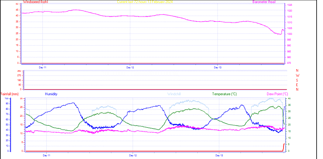

I have been having this WSW issue with the Wind Direction on a 3600 la Crosse for weeks now and it has almost driven me mad !
I have to climb an extremely steep goat track in my 4x4 to get to the station which is about 100 Metres up the top of a hill. I have been up and down that track more times in the last couple of weeks than ever before trying to work out this problem.
Every single day at 3 PM it goes WSW and pretty much sticks there until 8pm (Sunset). I have tried everything to fix it, even installing an external antenna on the base unit to ensure a good signal, but nothing helps.
You can see the problem graphed here,
