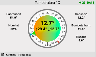

Hi!
This is my pwswd https://vilmeteo.es/pwsWD/index.php

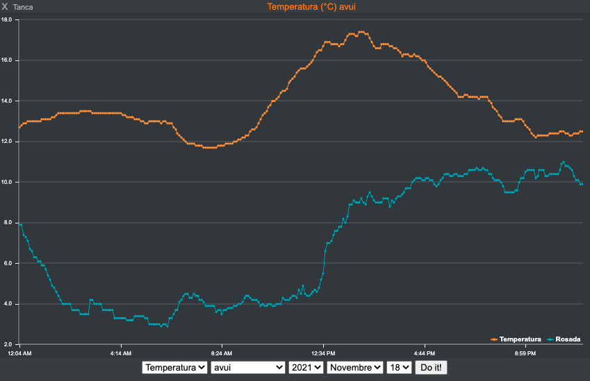

I realised that today there is a wrong high temp record. While the graph is showing a 18ºC high temp, the record is 29ºC. Why?
Attach two screenshots.
Also suspecting that month rainfall is repeating last month record.
Could you help me? Thanks in advance!

Just guessing about your problem:
Sometimes, during the day, invalid data is copied to the history file .
The graphs only use the data from WU and WU filters invalid data.
To test:
You could deleter the history file . . ./pwsWD/_my_settings/history.txt
Then we can follow the updates of that file during a few days.
We then can check if the cron-job runs at the correct time at 23:55
Be aware that high-lows use the reset at 00:00
If you are f.i. in Australia (09:00 reset) you can not use the PWS_Dashboard.
