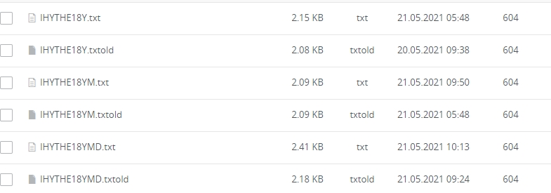

The data is in the location as you have said, but its not showing.
The data is being picked up by WU, as shown in the photos

Correct, and that data does not come from WU data.
Not everybody is uploading to WU + it is not as recent as the data from the weatherstation.
Therefor we use the cron and our own history.txt
