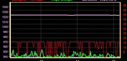

For some reason my version of Weatherdisplay is appears to be plotting wind gust speed upside down.
Is this a setting problem, if so how do I correct it so it looks like you webpage?

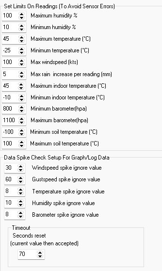

looks like you might have set a gust speed upper limit that is too low
Brian,
Thank for replying, I’ve looked though the settings including the ini file and I cannot seem to find any way to set the limit set the gust speed upper limit,am I missing something?

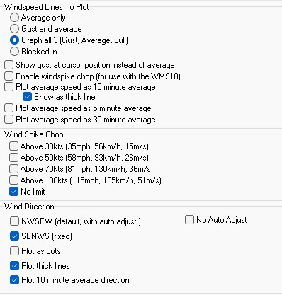

Have you tried Control Panel > Offsets & Initial Rain > Limits? There is a gustspeed spike limit setting there.
That’s the wrong tab. . . try Limits.
Ok,
So which values needs to be adjusted on windspeed-0.jpg, or do I need to change anything on windspeed-1.jpg.
