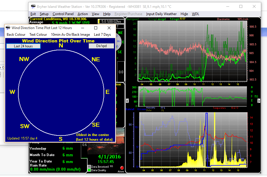

However, the one graph that remains blank is the Wind Direction Time Plotted.
I have trawled through the setups and the forums but can’t seem to find anything wrong or a fix from a previous user.
I am receiving good data for wind speed and direction on other graphs - see attached

ah
if you have that set to be uploaded to your web site, its OK then…
so this is a bug for if you do not
I wil investigate
try a restart of WD…that should fix it

I have done numerous restarts trying to clear it
Change a setting - do a restart etc
Still no joy
I don’t have this uploading to any website yet
Just local to my PC

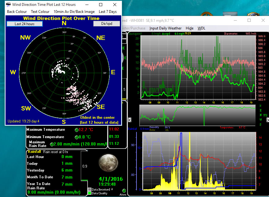

I have fixed this
in the latest .zip update of WD
(if you had it uploading then it was OK…but fixed that now)

there was someone else who reported this
but it was not until I realised this problem only occured if not set to be uploaded that I found the fix (1 line of code out of place)
