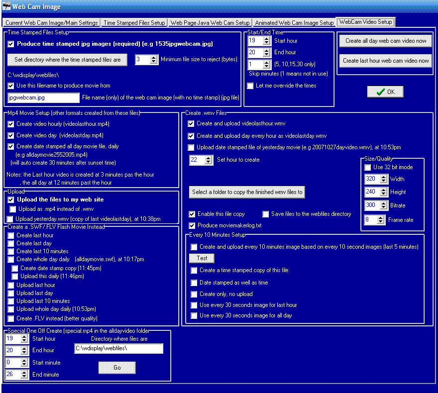

Hi, since updating to b80 I have been having problems with allday & videolastday videos, WD makes the movies witch are about 3.5 Mb & start 1 hour before sun rise stop 1hour after sun set & puts them in WD alldayvideo folder, if I let then let stay there sometimes for 2/3 days before I move them to another folder some were else when I check then they start about sun rise & finish about sun set & are only about 600/700/Kb, if I move then before the end of the day they are created they are OK, also I ticked the the box to create the files at nightime to but the webcamage jpeg stop saving in webfiles at sun set, then start saving from midnight onwards until sunset. Between sunset & midnight the webcamage jpeg updates OK & so does WUwebcam, the videos are all OK on my website & WU, I have not changed anything since updating, see screen shot of settings, using 10.37 b80 & movie maker version 3.8.00 7 windows XP.

for the problem 1, I will need your settings files to try and duplicate that problem
I have duplicate the problem, from your settings
you had not mentioned that you were using the every 30 second file creation option
I have fixed the problem,in build 83 if using that setting, for the time stamped files not being created after sunset

I also found out the problem with cheffy’s settings
he had set , let me override the times, in the all day video setup…untick that…
