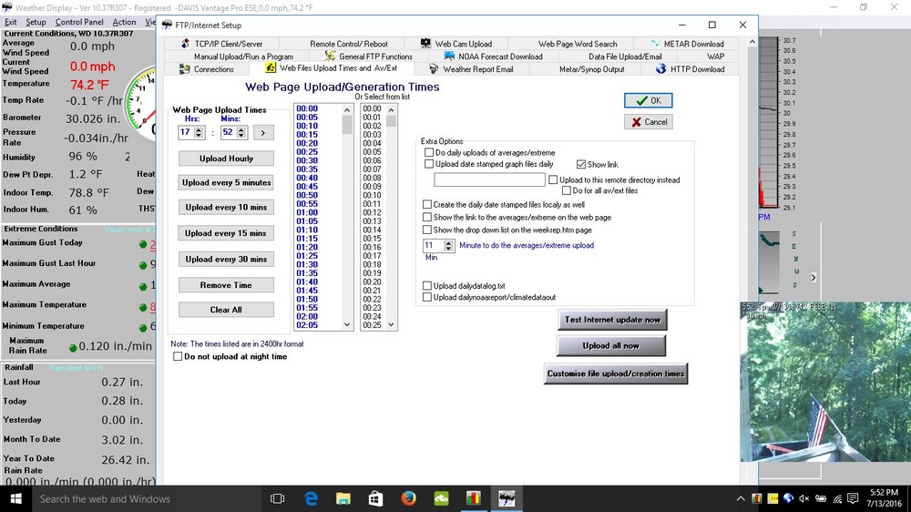

Here’s the only place I could find to check and it’s never been clicked.
but that is not the web cam upload setup screen
OK, I’ll check again but I don’t think I saw that option on the webcam upload times. Thanks for the help but will be a few days until I have a faster connection to use mypc

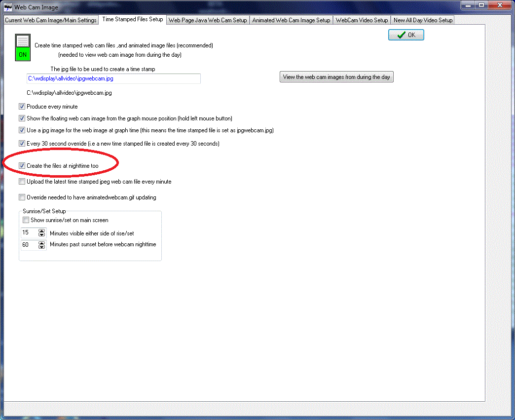

trust me, there is an option to only upload day time, in the web cam upload
Might be one of these two settings…
you would need to determine if the actual web cam image file is being updated in the webfiles folder or not
