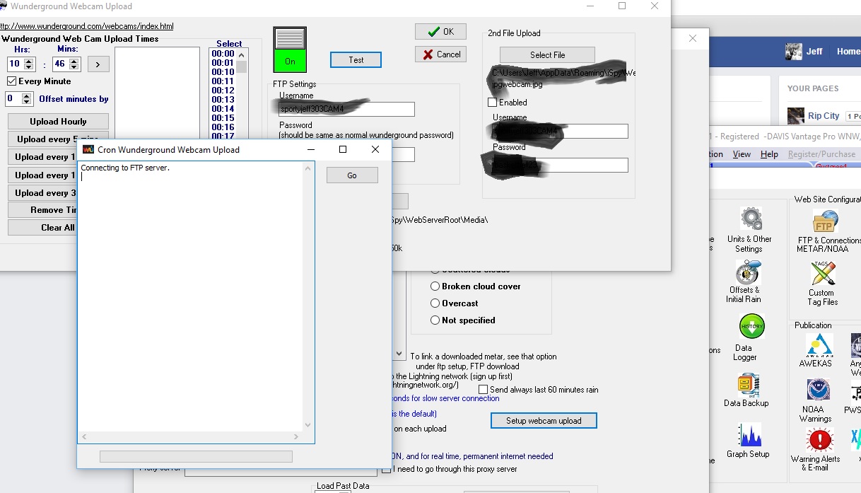

I had everything setup and working just fine. I updated to S21 and now its not being updated to wunderground. Web cam capture works fine and creates the 122kb file in my folder just fine. The problem is its not getting to my wunderground site where my station is linked to.
https://www.wunderground.com/webcams/sportyjeff303/4/show.html
as you can see it stopped on September 1st for some weird reason.
Attached is a picture of what pops up, but it does nothing and then just closes
Doesn’t appear you have any times set for uploads.
Wunderground is having ftp issues with there servers. Many reports of this issue the last few days.

Doesn't appear you have any times set for uploads.
1 minute update rate is set
that looks to be the problem
oh ok, hopefully wunderground has their stuff fixed soon
Ah, I missed the ticket mark.
I just noticed my webcam is not getting uploaded either.

you can set WU to grab the web cam image from a url instead
Yeah, the url way is working just fine.
windy2
5 September 2016 03:03
9
it could be that they now require secure FTP upload maybe?
Hard to say. From what I’ve been reading about this, it doesn’t mention anything SFTP. But that doesn’t mean much when it comes to WU.
At the moment, it’s working again.
