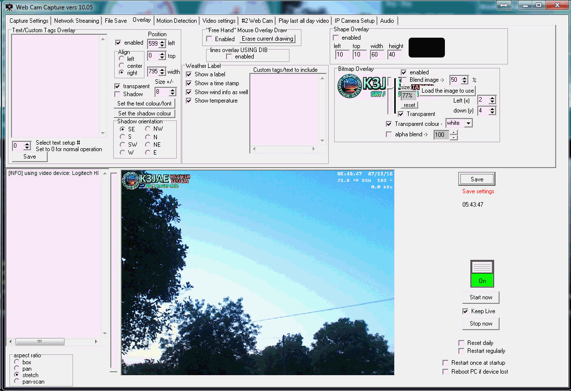

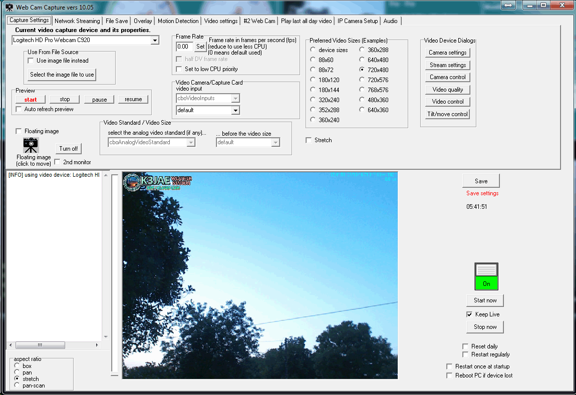

Not sure which tab you refer to… I have set the following
And last but not least - "Was not enough space in one post to do all…

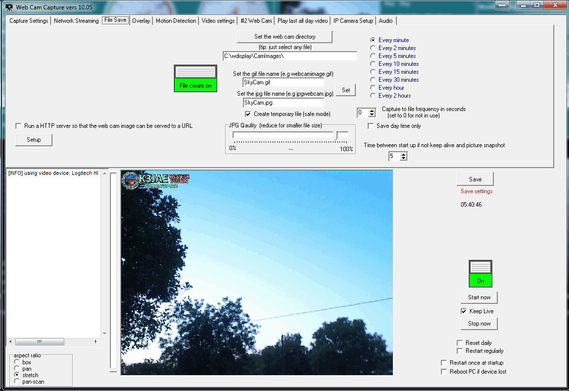

your last image shows what I am refering to
(the saving image as…)

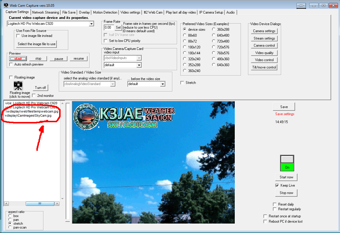

If I change the camera image size it gives me the info circled in red (below) info but after about 45 seconds to a minute that info disappears and only “using camera…” info is present.
Where do I change the setting to reflect the proper directory and/or filename? Am I to understand that the image is not properly being saved in wdisplay\webfiles?
every time it saves you should see that saved to location and file name information appear in that info pane

try unticking
create temporary file (safe mode)
OK, that resolved the Sumary Image and the tempwebcam.jpg issue. Thank you sir for that.
