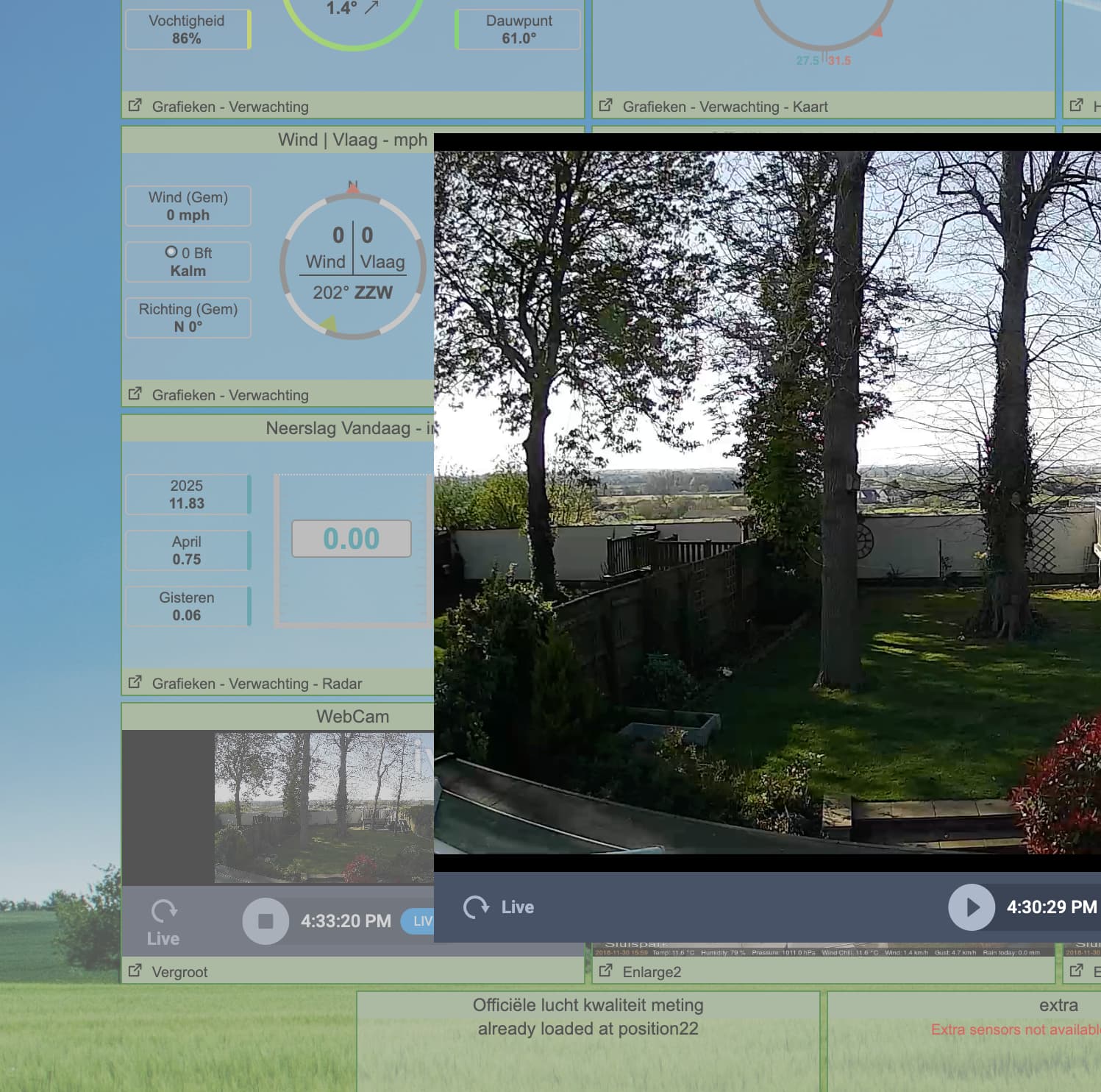

Webcam not enlarging
My webcam image no longer seems to be able to enlarge on my site - any advice please.

Hi alienburt,
The webcam_c_block.php|00|2020-05-11|'; # customized version
It uses a hard-code link for the movie, not your easyweather settings.
It works correct.
The webcam_c_block uses for the pop-up href="webcam_popup.php"
That script does not exists.
But that is not a problem as the clicking inside the image is captured by the video script itself.
It uses for the enlarge link: image_popup.php?nr=wcam1 with the link from your easyweather settings
That does not work as there are strange html characters in it.
I tested with your link and it needs a modification of your current image_popup.php|01|2022-11-22| lines 86-90 Change those to:
$n      = 'wcam1';
$pop_img[$n]['url']     = 'https://open.ivideon.com/embed/v2/?server=100-N0b0UhKpPaOXNNO0k4S6du&camera=65536&width=1920&height=1080&lang=en&ap=&fs=&noibw='; #$webcam_img.$extra_cam;
$pop_img[$n]['txt']     = 'webcam';
$pop_img[$n]['head']    = '';
$pop_img[$n]['show']    = 'frame';
It should look like this:
I have no idea how it could have worked in the past.
But with this small modification, it should work OK.
Perfect Wim, many thanks works perfectly.
