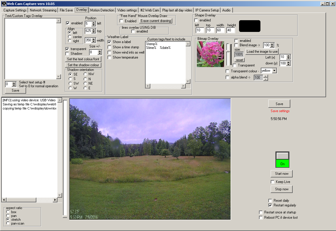

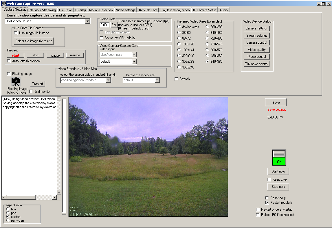

I tried using the winXP camera capture tool over 100 times and had no problems. Maybe 1 in 10 with WD are bad, usually at the bottom. Here’s another bad capture and some screen shots. Thanks…

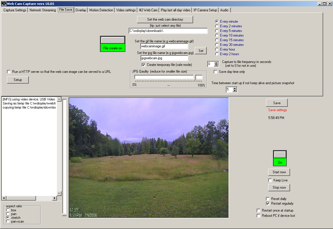

tick the keep alive setting
that will help
also you could set to save the file more often than every minute
Keep live seems to be helping, i’ve only seen one bad image so far, but the capture has stopped working twice in the last day [not WD, it’s fine]. Restarting WD clears, it up.
try unticking restart regularly now that you have ticked keep alive
