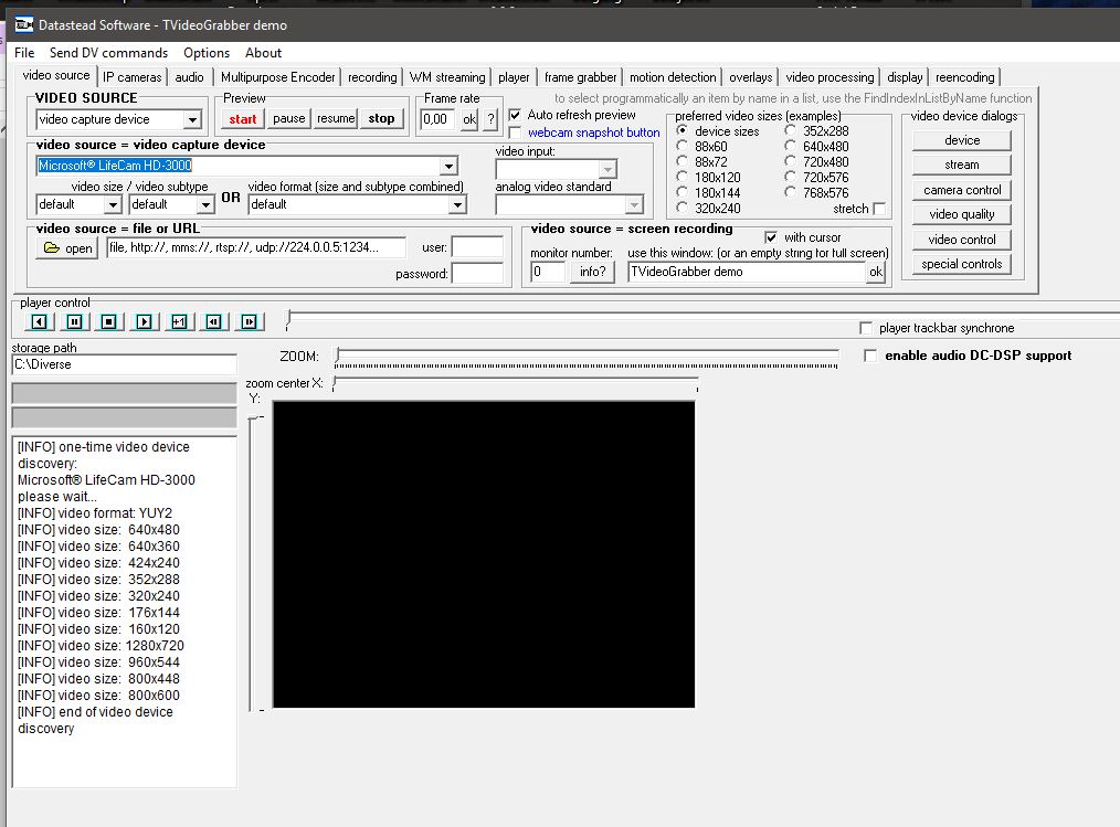

actually see if this demo works
http://www.weather-display.com/downloadfiles/MainDemo.zip
downloaded and tested.
Sorry Brian, prog find cam but only black screen. same same as wd.
I will contact the author…as that is the latest available version (june this year)
The demo works fine here. I had to hit the start preview button to get it started but it is working with my Logitech C920 camera. Bjorn did you hit the start button? I originally got the black screen until I manually started the preview. The other camera controls appear to be working as well. The demo has a nicer user interface in my opinion.
Yes, start was in use. Also tryed with logitech 525.
Play around more tomorrow. Night.
