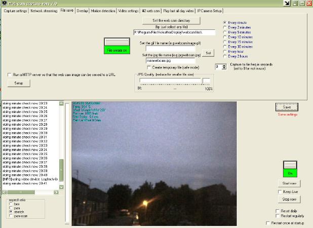

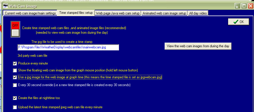

No, I haven’t got the java webcam set up. I have set to create every minute a jpg image called mainwebcam, within webcamcapture.exe, and this image is displayed as I want it on the main WD ‘front end’. To get a timestamped jpg, every minute image, I have set from within the webcam settings page called from control panel/webcam…screen print attached. What I do not want is an animated gif, but it seems the only way i get time stamped images is by selecting to create an animated gif…which is not what i want.

Trev,
I would try and Turn that OFF and just make sure you have set the Webcamcapture settings under File Save set, Turned On, directory set and every minute selected.
The screen you are showing is for other aspects such as the all day web cam image panel…

I couldn’t post my webcamcapture settings yesterday, but I have attached them here. To re-iterate…all I want is a timestamped, every minute save of the file mainwebcam.jpg (must be jpg as quality of gif is rubbish), I do not want several intances of gif files called newxxx1, newxxx2, etc. If it can’t be done, then so be it, but I’m sure I have done this in the past. #-o

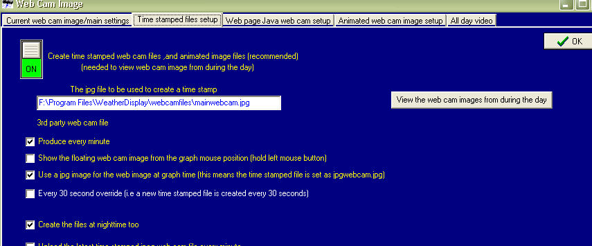

So, to get it clear, what/where should I be setting to create timestamped webcam jpg files, this screen here attached ? (This screen shot shows it not being set, but I have had this set…and I still do not get timestamped files.)

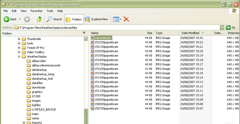

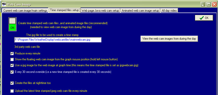

OK, I have got this to work for me now, but it looks like there is a bug in the webcam settings module within WD.
I have now got timestamped jpg files being produced,(called *jpgwebcam.jpg), every minute but only if I set the ‘Every 30 second override’ feature, as well as the ‘produce every minute’ setting. These files are being created every minute, as I require, but are being timestamped with a 30 second filename, ie ‘182030jpgwebcam.jpg’. Screen shots of settings that give me these results along with my folder display showing the ‘30 second filename’.
If I ‘unselect’ the 30 second override, and only have the ‘produce every minute’ set, I no longer have any timestamped files.
So, as I am now getting my files, every minute as I want, but not quite in the way WD should get me the files, I am happy, but perhaps this is something that needs looking at…
…and my folder display screen shot showing the ‘30 second’ time stamped files, that are actually created every minute !!!
you will most likely find that if you check the file properties that file is being created near to the 30 second mark (i.e the create time in the file list you have shown does not show seconds)
Yes Brian, the file is being created approx at the 30 second mark, every minute, (even though the wording on that setting suggests files to be created every 30 seconds). My query is, why do I not get timestamped jpg files every minute, if I only have ‘produce every minute’ set…why do i need to have ‘30 second override’ set as well for time stamped files to be produced ?
