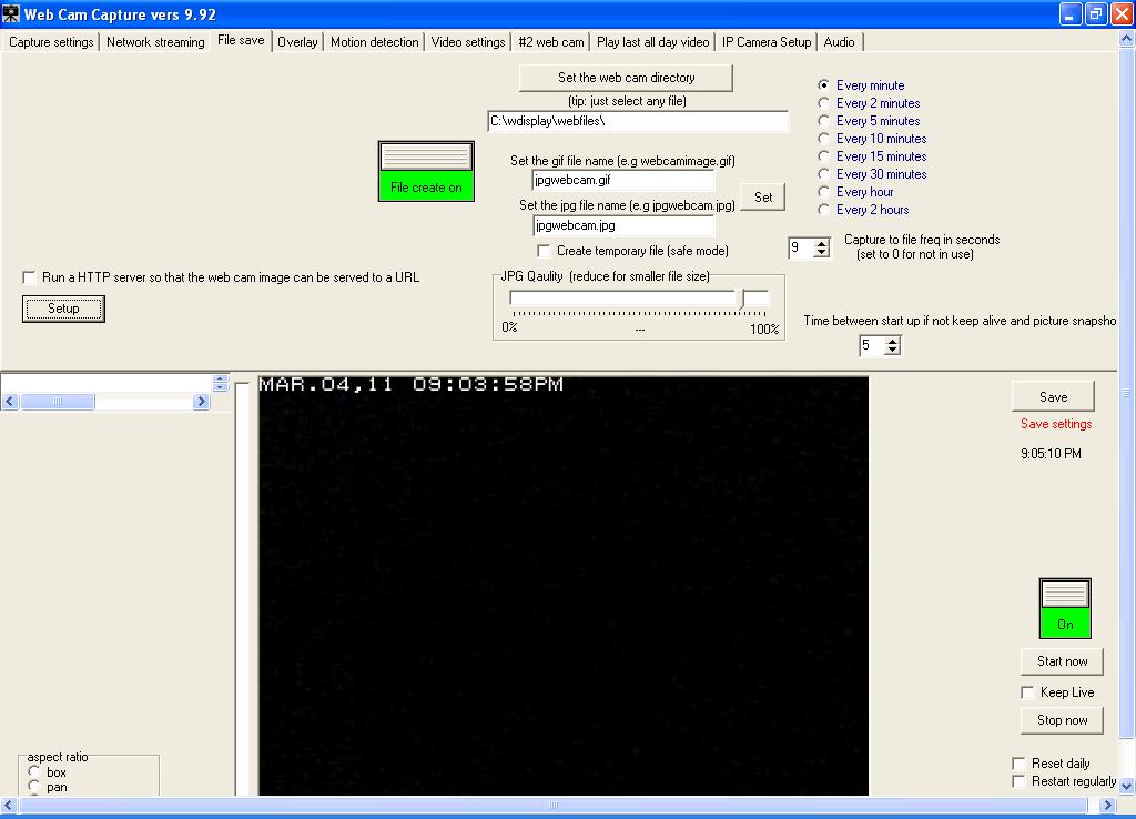

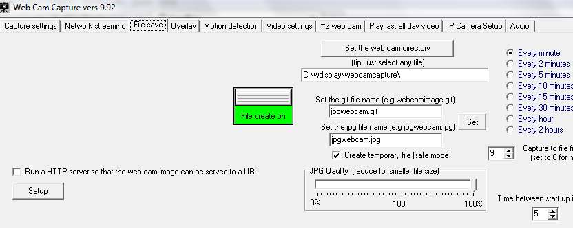

In the web cam capture program, go to the “File Save” tab to set the file to be saved. (example attached)

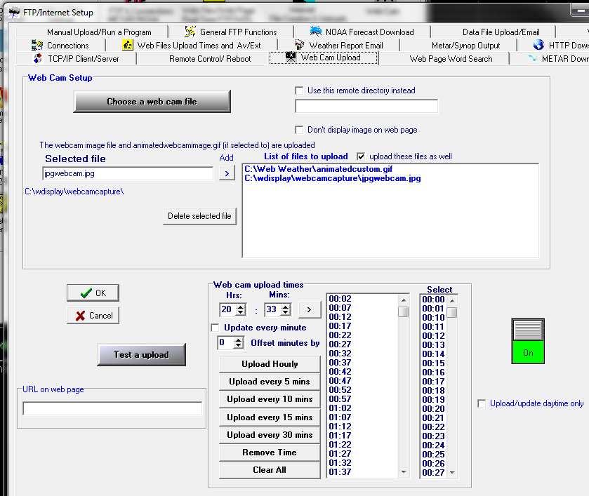

Then open WD / Control Panel / FTP & Connections / Web Cam Upload tab and set the file to be uploaded and timing. (example attached).
still not working here is a snap shot what i did .

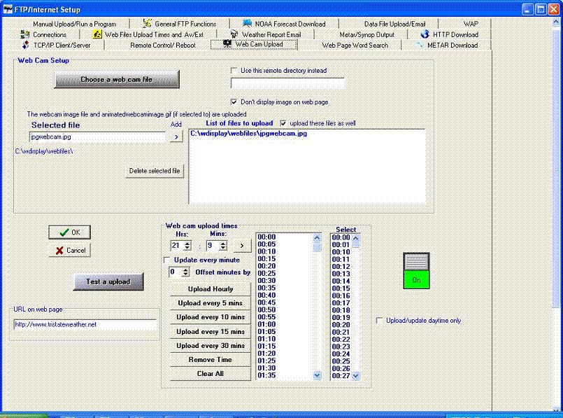

2 nd picture
when it loads, the web page still show this address . Does matter ?
its not clear what the exact problem is at this stage?
I do note that you have ticked to not show on web page and also you do not have the URL set correct
in the screen shot

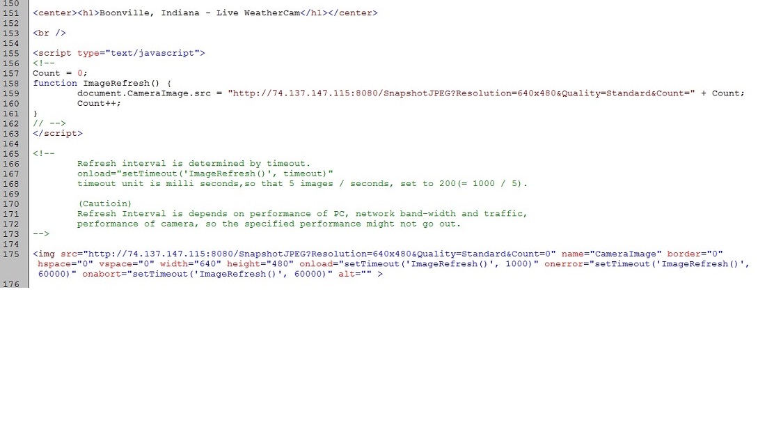

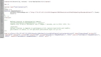

I pull ed the veiw source from this page http://tristateweather.net/wxwebcam.php
Line 159 ot 175 show the address its pulling from .It does not work .If this is right , how do i change this ?

Your webcam is uploading to the internet at this address:http://74.137.145.87:8080/SnapshotJPEG?Resolution=640x480 with out using WD.
Try this, On your index page, change:
  <img src="http://74.137.147.115:8080/SnapshotJPEG?Resolution=640x480&amp;Quality=Standard&amp;View=Normal&amp;Count=40507551" alt="webcam"
    width="320" height="240" style="margin: 0px; padding: 0px; border: none" />
To this:
  <img src="http://74.137.145.87:8080/SnapshotJPEG?Resolution=640x480" alt="webcam"
It appears that you posted the same time I did. For what ever reason, your camera’s IP address has changed from 74.137.147.115:8080 to 74.137.145.87:8080. So where ever you have the original address, change it to the new one and see if that works.
If this happens again, the camera’s IP is dynamic (changes all the time) and needs to be static (non changing).
