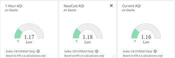

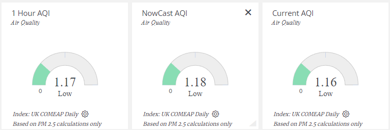

Well, the index values that are coming from the API of AirLink are UK index values, you can see them on my home page and here: Wareham Weather - Air Quality
^ Those values are coming directly from AirLink itself.
^ WeatherLink
I don’t think your air quality values are what you think they are, i.e. real UK Index values. Where is your Airlink unit getting the NO2/SO2/O3 readings from when it doesn’t have built-in sensors to measure the concentrations of those gases? At best WeatherLink could combine your local PM data from the nearest ‘official’ unit with your local PM readings, but in many cases the nearest official unit is tens of miles away so isn’t really a good measure of your local environment. So perhaps you should really be asking Davis whether they’re really providing UK DAQI values.
I think you have incredibly high expectations of features that must be supported by low cost/free software. There is no obligation for any software author to try to support any and all standards/units from all parts of the world.
I just zoomed in on your Weatherlink AQI images and it’s worse than I thought. They’re only based on PM2.5 readings. That means they don’t include 5 other values that are part of the UK Air Quality Index calculation. So displaying them as UK Index values would actually be misleading.
