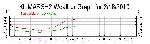

I have been running Weather Display for around 3 years now. The entire time I have been uploading Data to Weather Wunderground without any problems at all. Now my PWS is now longer being displayed on their Web Site. I have checked and double checked all my settings and I can not find anything wrong. I sent an email to Weather Wunderground and they tell me I am not uploading DATA. Can someone please point me in the right direction? What can I do or check to try and get this resolved. Prior to this happening I have not made any changes to my setup. Since this problem started a couple days ago I have updated to the latest version of WD.
If this helps my weather station name on Weather Wunderground is KILMARSH2
Thank You
Steve
www.ai9t.com/weather.html
Check your ftp logs for errors.
add: Looks like it quit just after noon on the 18th.

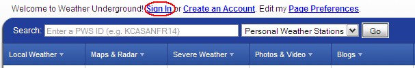

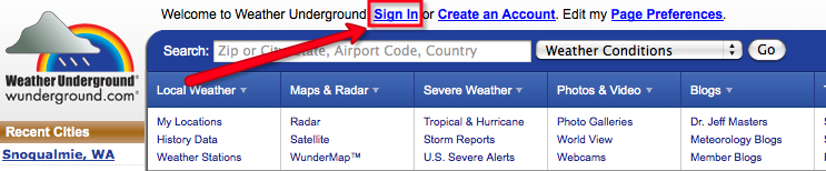

See attachment for signing in to WU…

It shows up for me. Maybe you can’t see a .png? Here’s a .jpg version.
-Keith
I got that OK, Thanks, I guess I got the other too but it didn’t register with me for some reason.
