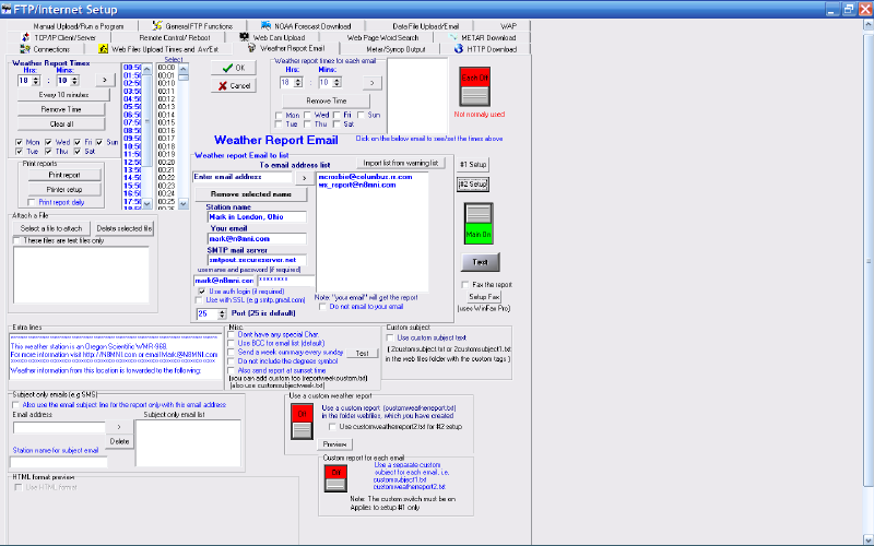

Post a screen shot of your email setup…
screen shot

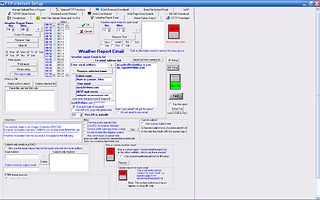

hmmmm. Try this… clear all your times. then set a few of them to different upload times than what you have your gifs and jpegs uploading and see if that works. maybe things are clashing on upload times. I will attach my settings. I have 3 times set because of my needs. but our settings are close.

Hard to tell but it almost looks like the Number 2 setup is selected? Do you have these settings in the Number 1 setup and in the number 1 setup only?
Setup one is email to friends a couple times a day.
Setup two is email to EMA and local weather stations, set to send every hour.
Neither setup is sending unless I hit the “Test” button.
Seup two is temp set to just my emails for testing.
