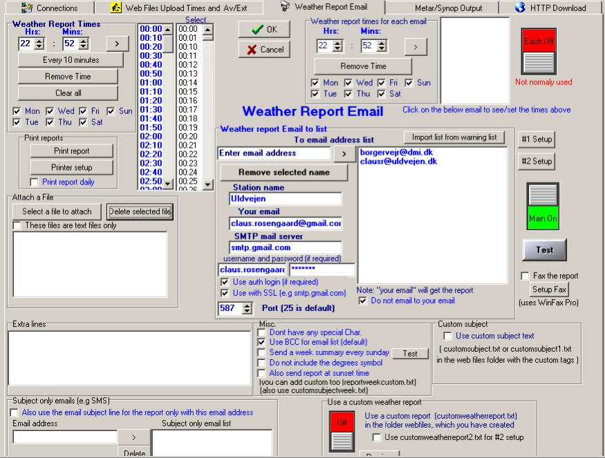

post a screen shot of the email weather report setup
Thanks for your comments. I have tried to add several email addresses to avoid being caught in a SPAM filter as well as checked the SPAM folders, but so forth nothing. I have checked that there isn’t a firewall blocking, and there isn’t. I have used three different SMTP services including Google and standard port 25-no identification provided by my employer.
I have removed reports.txt as instructed, and the Wather Report Email window now looks as in the appended JPG. Any observations are very welcome!

I just set up a new WD instance using a gmail account, hit the Test button and it worked immediately. That’s the same result I have had previously :dontknow:
Update: Confirmed port 587 does not work for gmail. Did you try port 465 as I recommended above?
Thanks for the advice!
You are right, it works with port 465. Strange, as my Mozilla Thunderbird Gmail setup uses 587. For some strange reason it tries to send the email twice, which Googles SMTP server complains about. That isn’t a problem, as the duplicate address is just ignored. I checked the registry to see if the email address was duplicated in the list of recipients, but it isn’t. Here is the latest log-file:
