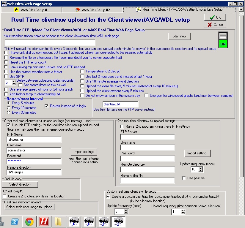

All of the usual Weather Display files are being FTP’ed to the directory that has the Gauges files in them.
I have put the customclientrawlocal.txt into the Webfiles directory of the copy of Weather Display I want to produce these files.
Have ticked the box to create the CustomClientRaw.txt file (see attached) with the times set but all I get is the usual files.

try re selecting the clientraw location directory
also it looks like you have multiple copies of WD running?
I have the folder currently pointing at the webserver folders on the weather server is that the correct location?
The webfolders points to the correct location.
I have 4 copies of WD running and I did the suggestion to put the wd.txt in each directory which fixed the problem with settings showing up in all copies running.
