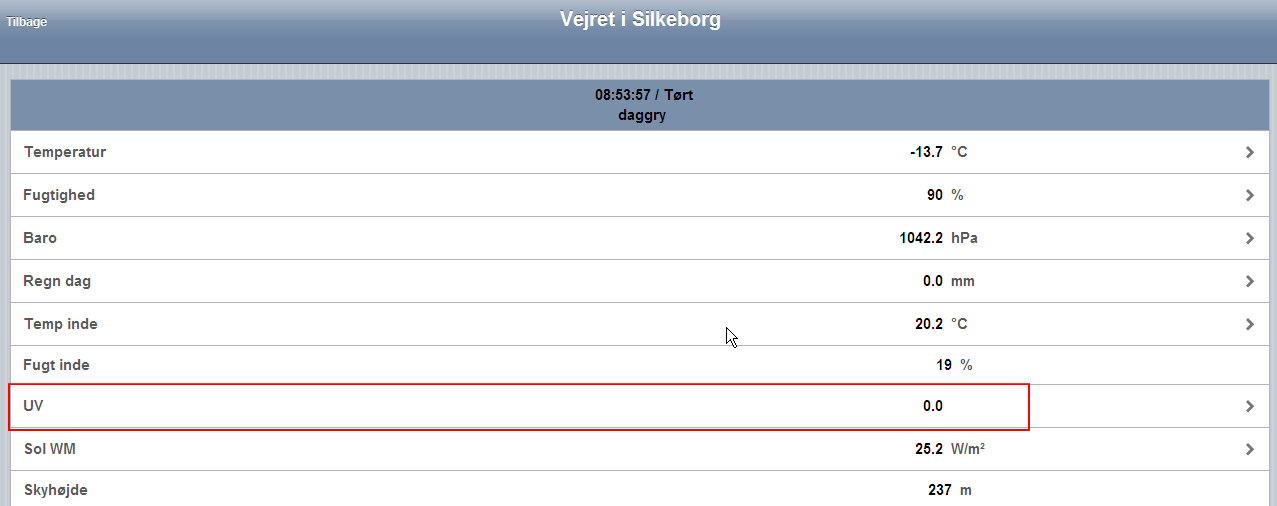

I dont have an UV sensor - and the UV reading is in the live data with 0.0 - I would prefer it was not shown there - and I know I can remove field 79 from this line in the settings:
settings[“live_screen”] = [4, 5, 6, 7, 12, 13, 79, 127, 73, 3, 1, 2, 44, 45];
But it would be easier to define it in a UV/Solar setting - then you dont need to remember the fieldnumbers.
About the stationname - would it be possible to add more width - as I can see on my mobile screen that there is space for more charaters.
Hope the above makes sense - see attached pic.
Henrik
