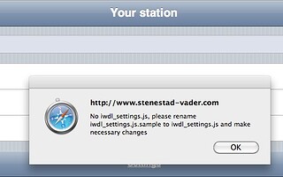

why is it a picture at startup (see attached picture)?
I changed the name of the file, which it says that you should do.
Clicking “OK” in the picture, then starts all right.
What am I doing wrong?
Here is my iwdl
http://www.stenestad-vader.com/iwdl/index.html
Greetings Bertil
Your settings file says:
settings[“clientraw_dir”] = “”;
It is not meant to be an empty string; if you want the current directory, please try ./
Sietse
Thanks for your help,
tested with. / as you mentioned - did not work.
When I tried to … / so it worked as it should.
(I have my clientraw file in the root directory, so where was the error).
Once again thanks for your help
Bertil
