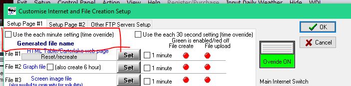

I have finally found what appears to have been my issue…and I am annoyed I didn’t spot this before now.
On the Customise Internet & File Creation Set up, under Setup Page #1 tab, the tickbox 'Use the each minute setting (‘time override’) was ticked. See attached.
My every minute freeze is now down to 7 to 8 seconds, which I can live with even though i would expect a PC with 16gb of ram to be able to process the file creations and updates better. I will see if I can get it lower, but not sure there is anything else left that I can unset to achieve that.
