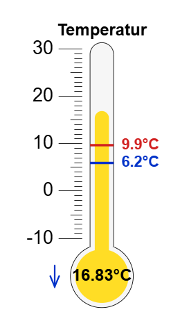

WD Temperature is maxing out at 9.9C lately even when it is hotter than that
WD Temerature is maxing out at 9.9C lately even when it is hotter than that.
(it also display the correct temp, but meteotemplate is showing 9.9C)
Any hints of whow to fix? reboot of the vantage pro and pc’s doesn’t help, neither a reinstall of WD helps… is an issue with the realtime file or some other file I can delete to be recreated?

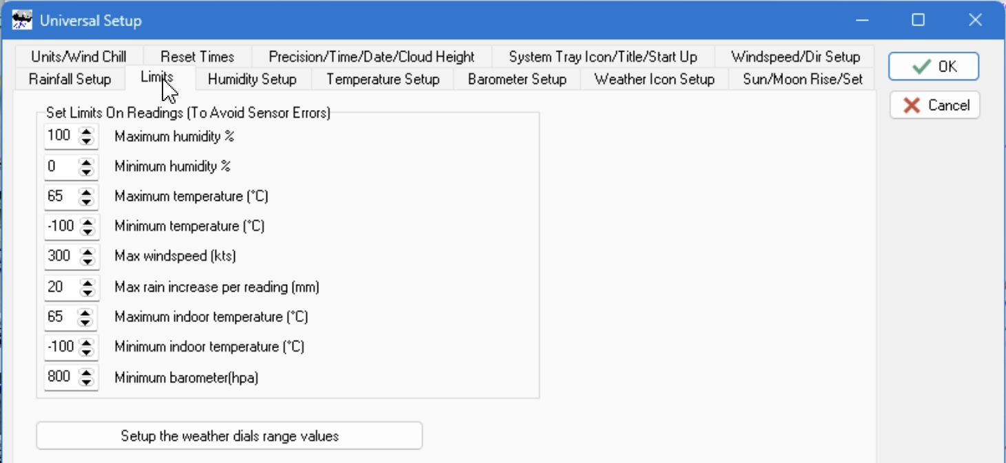

WD has settings for maximum and minimum temperatures so perhaps the max temperature setting is corrupt? Sorry, I can’t remember where the settings are because I’ve not used the Windows version for some time.
I’ve not used MeteoTemplate for some time either, but I think it’s also has similar settings.

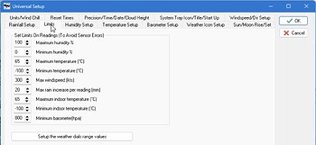

The max min are set here
And should be as attached which are the default settings
