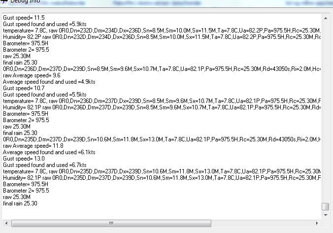

setup, advanced/misc, tick to log the raw data, then post a snippet of that here that shows under view, debug info
Hello,
Please see Attached file. Date on the file i downloaded:Version on 20 December 2015 - 20:29:41 Guess it refers to my local time.
Tor Erik
that all looks correct
what do you say its not correct?
Example the last row. Gust speed from Vaisala: Sx=13.0M ->13m/s meter pr second. According to the debug, WD changes this to 6.7 kts knots. This is not right.

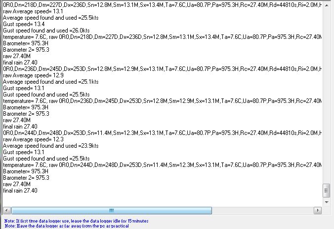

Added the debug file taken with the very old version of WD. Jus to show how it should look like.
Tor Erik
you are right
WD was going the wrong way with the calculation (should have times instead of divide)
me must be under too much stress, need a holiday
use a new .zip update, ready now
