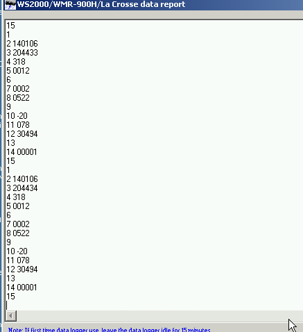

you will need to set the log raw data and let me know what shows under view, WS2010/WS2500 data setup
see attached
Current temp -2.0
appears to be #10
try a new .zip update, ready now
