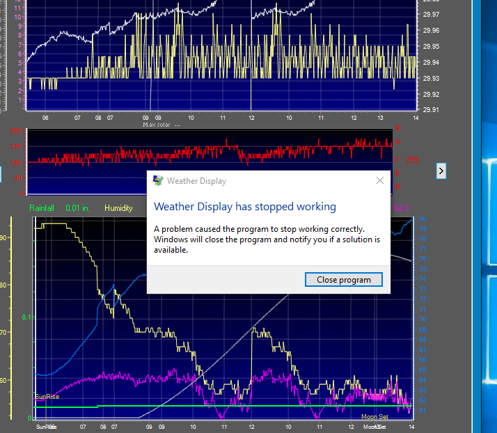

I’ve been on Windows 10 for many months and had no issues with WD. This weekend, when I was out of town I noticed it had stopped updating early this morning. I used remote desktop and went in and stopped WD and rebooted the PC. WD starts but then soon after it starts I get the Windows error, see first jpg. I tried downgrading to an older version, rebooted several times and it still get the error. I’m home now and checked my Windows event viewer and I have attached the second jpg to show the error. I’m stumped, any ideas?

I just tried it again and it ran about 5 minutes before the error. WD Real Time FTP was running and I saw realtime ftp run once

I also noticed I get the error and crash soon after the realtime.ftp runs. Not sure if is id part of the problem.

I backed up the wdisplay.ini file and then deleted it from the directory. I started WD and let it sit before configuring it, it did not crash. I started to configure and soon after I assigned the comm port I got the error. I also noticed that when I start WD it can load data for 20 minutes with no issues but once it starts sending data I get the error. The Realtimeftp seems to run fine it appears that the crash usually happens after the first or second time the WD ftp runs.
