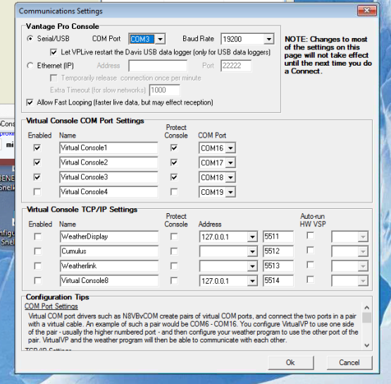

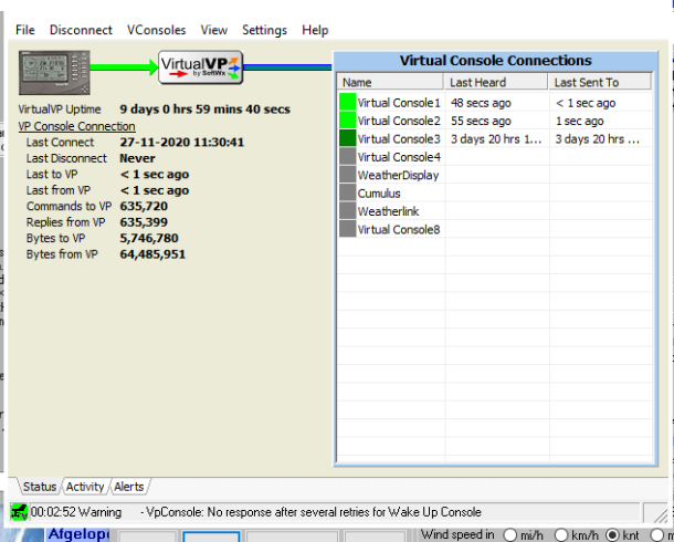

I don’t know if this is still an issue but i have WD, Cumulus à nd Weatherlink on the same comport.
You need this soft from Eterlogic and Virtual VP of course!
This is my setup should you consider of trying it out…See attached!
Soft from eterlogic found here http://www.eterlogic.com/Products.VSPE.html
Let me know if you wanna give it a stab!
