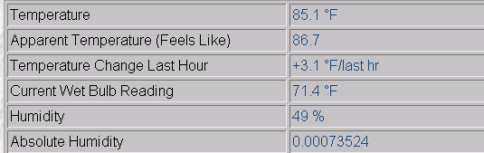

Ok, I’m not sure how the answer WD gives should be read as.

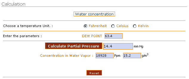

85 F, 49%, should be about 6.3 grains per cubic foot (based on Jeep’s table).
ahh, i need to convert the pressure, i.e *100
i forgot to do that
will do that
note that it will be in kg/m3

what is the url jeep to that calculation you had a screen shot of?
Does this page help? http://www.gorhamschaffler.com/humidity_formulas.htm
I believe this is the site that Jeep’s pic comes from (follow the links to the calculators) http://www.humirel.com/All_about_humidity.htm
yes, that’s the one. Actual link to the calculator is:http://www.humirel.com/All_about_humidity-calculation4.htm

I don’t know other weather software what know how to calculate abshum.
It works fine! Now I must only learning what meaning when abshum is 0.06528904 kg/m3 :slight_smile:
Eki
yes, i uploaded a new 10.27n, with that 100 * fix…so it should be OK now(but note its as kg/m3)
Could this change to g/m3? My point is; 64.43870 is more easily understand as 0.06443870.
yes, sure
10.27o i will get uploaded today
Works fine with 10.27q
