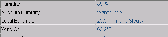

try a new 10.27L zip download…
and the tag is %abshum%
Cool, I’m at work till 1:30 A.M… As soon as I get home I’ll d/l and try it out. Thanks Brian!
Not quite there yet Brian. The tags not getting filled.
that wll mean you have not got the correct version yet…
try a new download…
OK, Downloaded again, and it’s showing 0.0
Ahhh…that will be absolute zero humidity :wink:
Heh, it’s been absolute zero humidity for a couple of days now… my skin is REALLY starting to itch…
